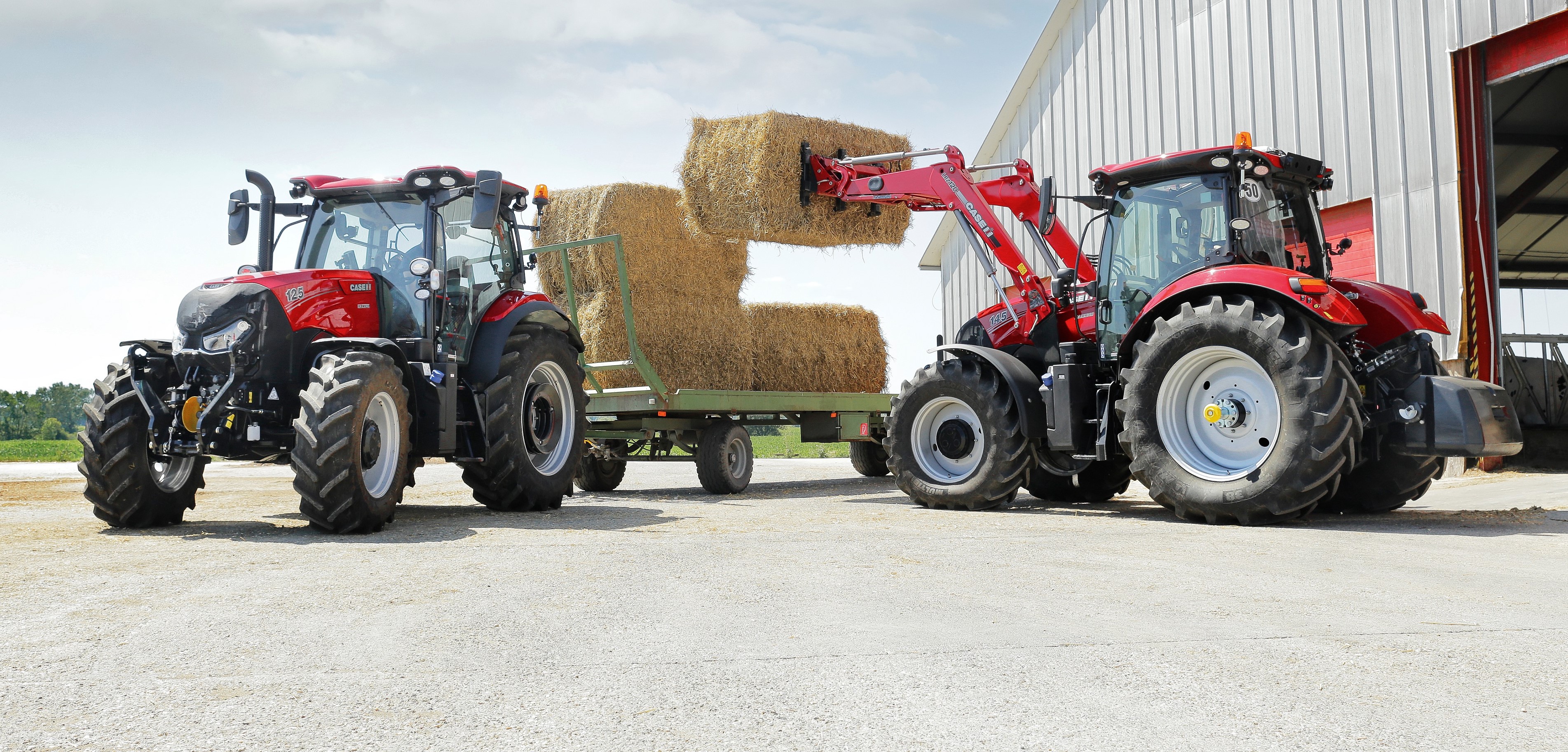

Case and New Holland already announce the sales date of their 8 speed DSG gearbox:
This ratio spacing and reach is similar to Deeres, and most ideal. Full traction available in 2nd range 1st gear. Shift from 2 to 3rd range is at high enough speed to make sure the momentum keeps rolling while the range is changed.
