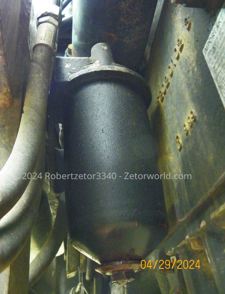

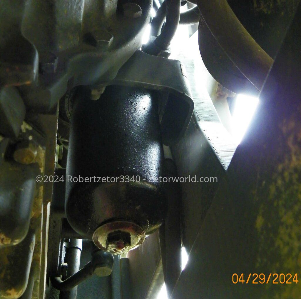

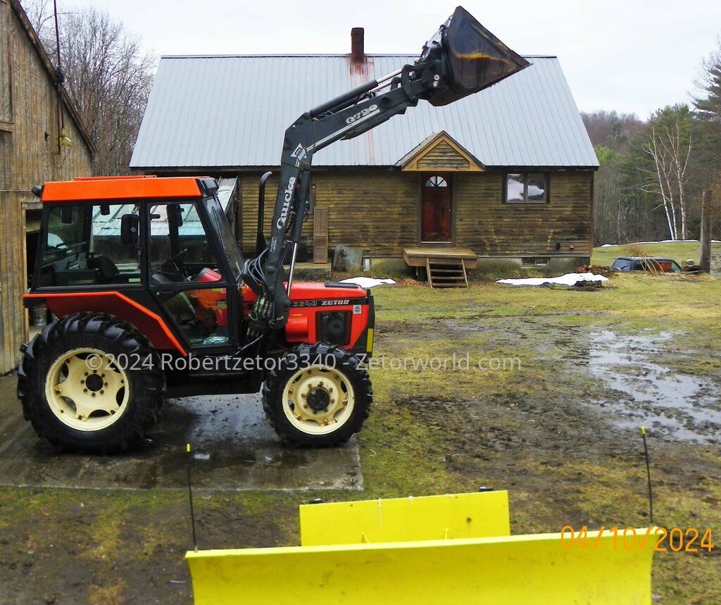

The Hydraulic/Transmission oil looks dirty, and may not have been serviced for a long time now, so I want to service it.
I purchased this Zetor 3340 1999 with a shuttle-shift Transmission just this past February.
What kind Hydraulic/Transmission oil do I need for it? :confused:
Also what filters do I need for it too?
The engine oil was done back July 2022, so I would to to service the Z-5203 engine oil also.
I want change the front wheel oil too. I have never done any of those before too.
Any help and suggestions is very appreciated. :)

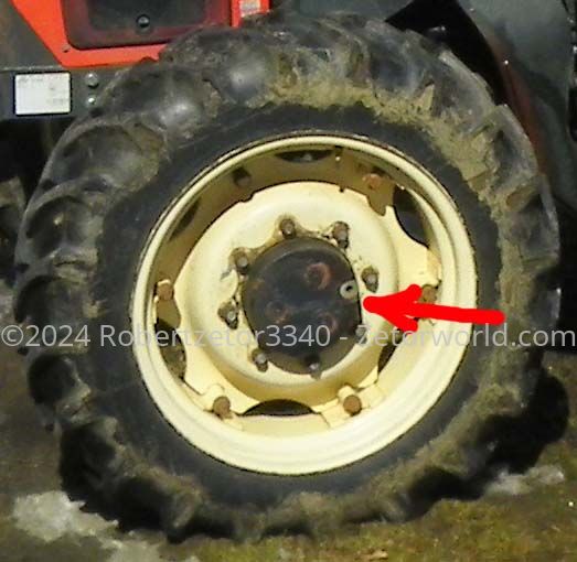

Do you know what oil the front-axle wheels use ?

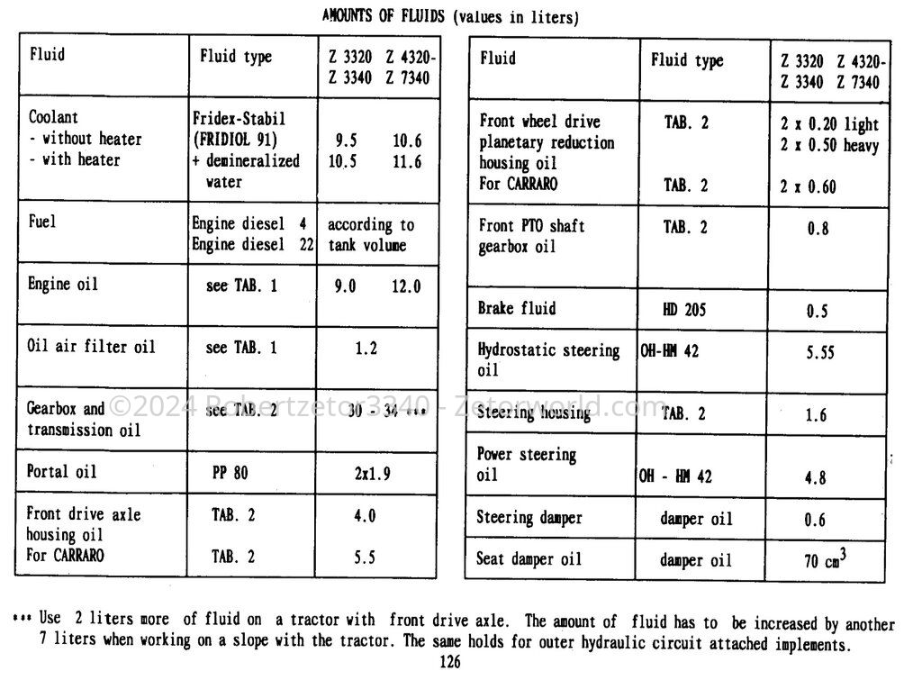

I found this:
Oil for Front-Wheel-Drive Planetary Reduction Housing Oil = TAB 2 (2 x 0.20 Light or is it 2 x 0.50 heavy)
But I am not sure what it means.

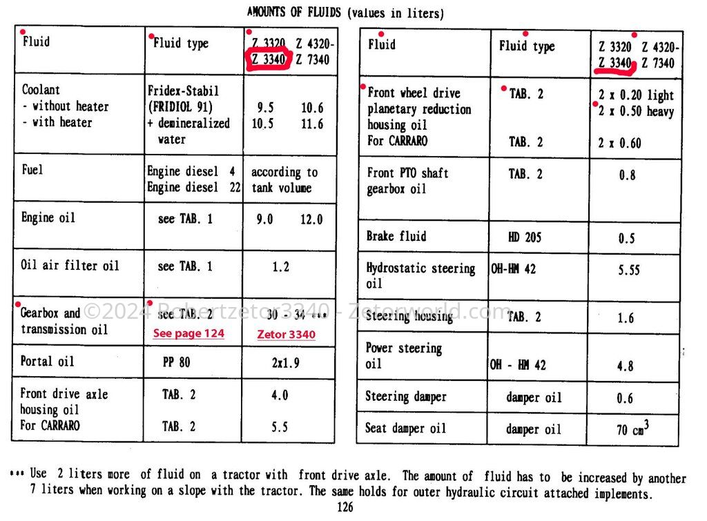

I found this in the manual, Front Axle Differential Housing (Cas Carraro Axle): about 1.5 gallons (about 5.5 Liters)
