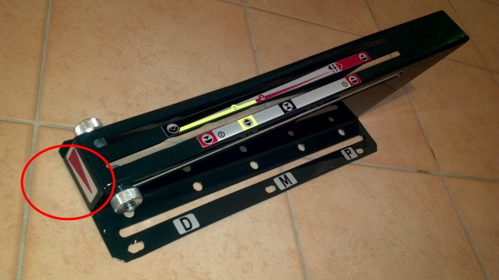

there is a twist lever on the vertical part of the cab floor (the step in the floor) right in front of the seat. It controls the flow. Try twisting it left or right to see if it makes a difference.
Hi Renze,
you mean the twist lever mounted bevor/under this part?
full
They is only to speed up or slow down the 3-point lift and changes nothing on the external hydraulic circurit on witch the loader is mounted. Tested just yesterday on my Zetor 5011. ;)
Regards, Joachim
Yes. Are you sure it only slows down the 3pt ?
I never use that lever anyways. It's useless with only a 20 liter pump behind it :p
