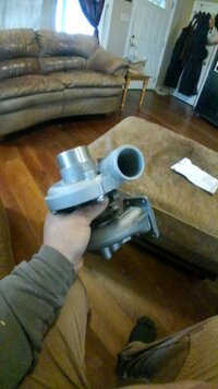

Is there a different make of turbo that is a direct replacement for the OEM on a 73 series? There are bunches advertised at half the price but I'm not sure any of them will work.
Brand new original turbochargers for a Zetor 7340 currently cost around 600-750 €.
If you are offered some at half price, they are either poorly reconditioned or simply the cheapest of poor quality. You get what you pay for. ;)
Not here in The States. Not sure on the exchange rate, but they are $1100-$1200 here. Similar looking ones are half. I think I even saw a Garrett that was considerably cheaper.
