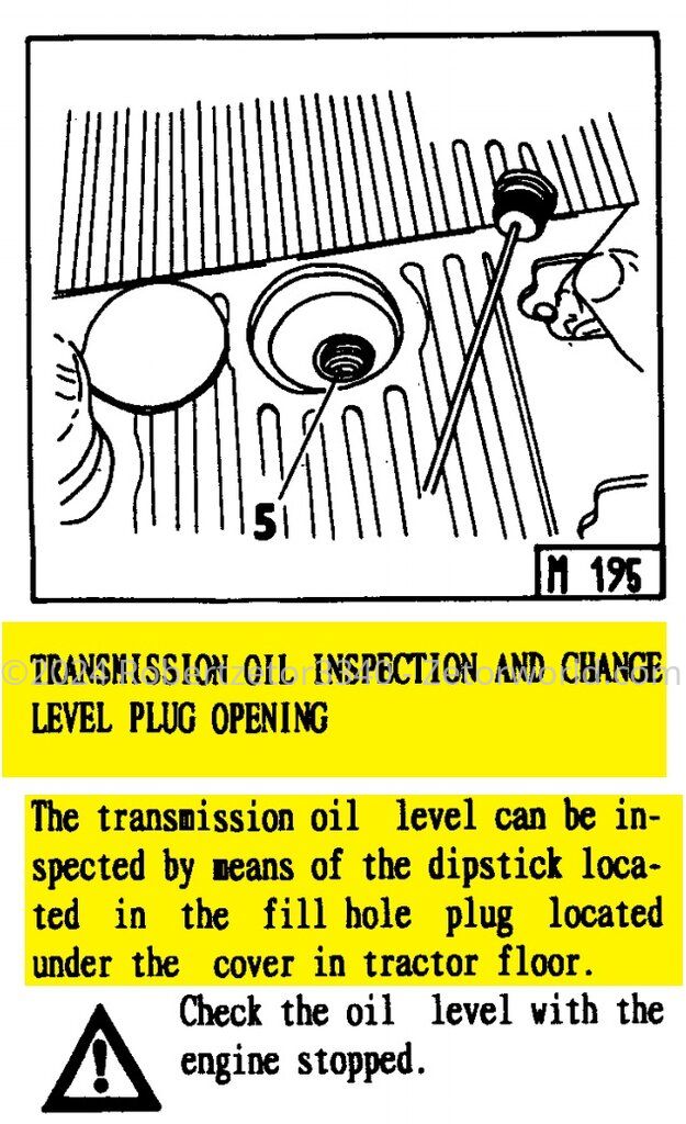

question Zetor Proxima 6441 - Hydraulic oil refill ?
It may be under the floor of the cab near the transmission.
