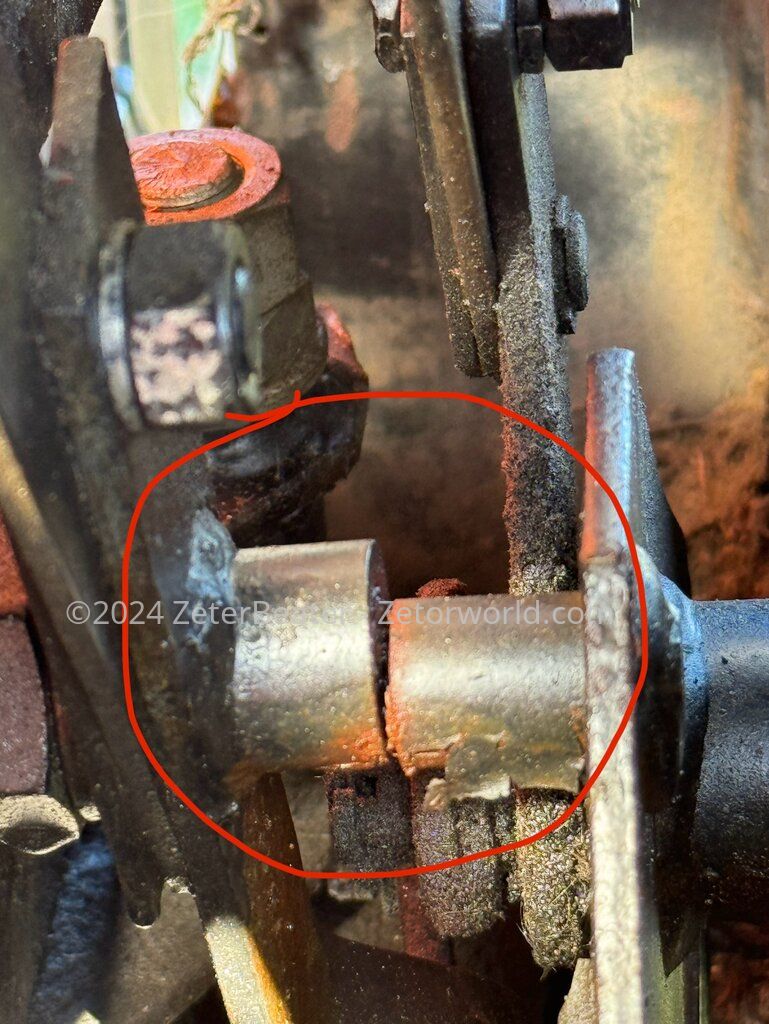

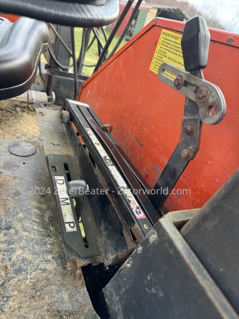

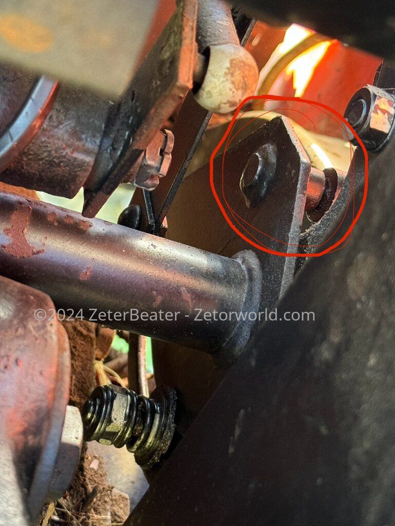

I was plowing for the first time yesterday and the long lift lever was super tight so I lubed it up and it got a little better but 2 rows later (I was only able to do 5 total!) :( something broke. It looks like the bottom hinge pin is still good but where ever it connects to appears to have sheared? It’s very hard to see in that very small space which has lots of levers and poles connecting lol.
I’m not even sure of the part names or what connects to what. Any help is appreciated.

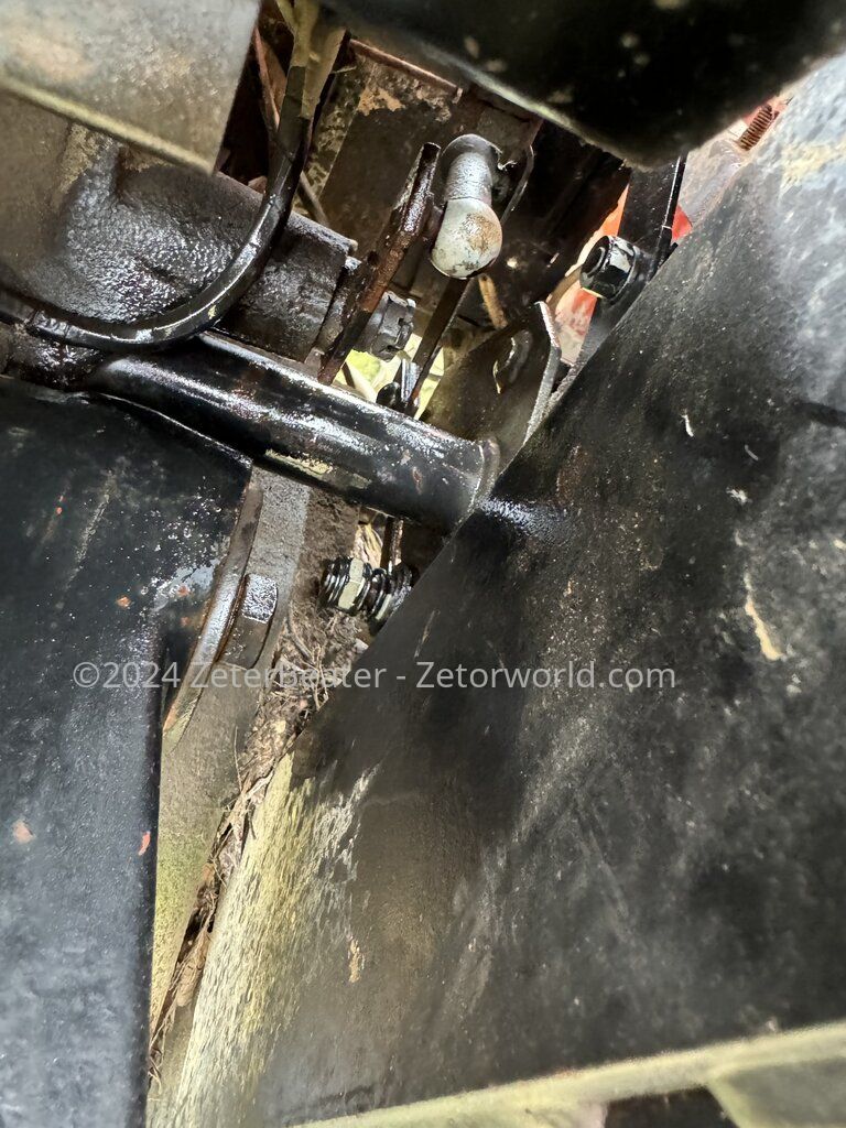

Here are better pictures. Yes whatever this was, a screw or something has sheared. I don;t even know where to start as it looks like it is a bolt that screws into a welded part and there are inches to work here, so tapping it to get the end out is just not possible. What a nightmare. Please tell me im wrong, lol.
How hard is it to change the whole plate part (that has the welded side) and what's it called?
I need to get this fixed ASAP so I can prep my field :(

But I think you can only remove the shaft that you broke off and which is rusted when you have dismantled the entire upper hydraulic system.
So take out the seat, take out the rear floor panel, take out the lower rear window frame and then remove the lifting struts and then... remove the upper hydraulic cover.
Then you get to the wave.

Hi Zetor Beater,
I also am a new owner of a 1999 3340 and when I tried moving the lever back to raise the 3-point hitch,
it was so dirt rusted up that it must have been never been moved up past the half way position for many years.
I soaked it with B'LASTER PB Penetrant Pro oil and pushing the lever with my foot,
with working it back and forth it did cleaned up.
It now works properly,
but that part is not a help for you needing to fix your broken part.
Before I got it freed up I was seeing it was going to be a hard place to get to.
I was thinking, I needed to remove the fender if possible.
So I am very interested to know the best way to get at this linkage too.
The video and pictures are helpful
and the instructions: take out the seat,
and then remove the upper hydraulic cover.

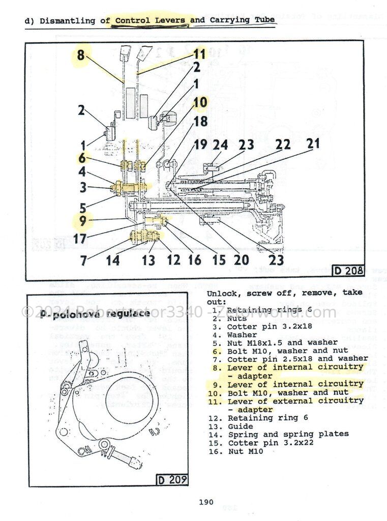

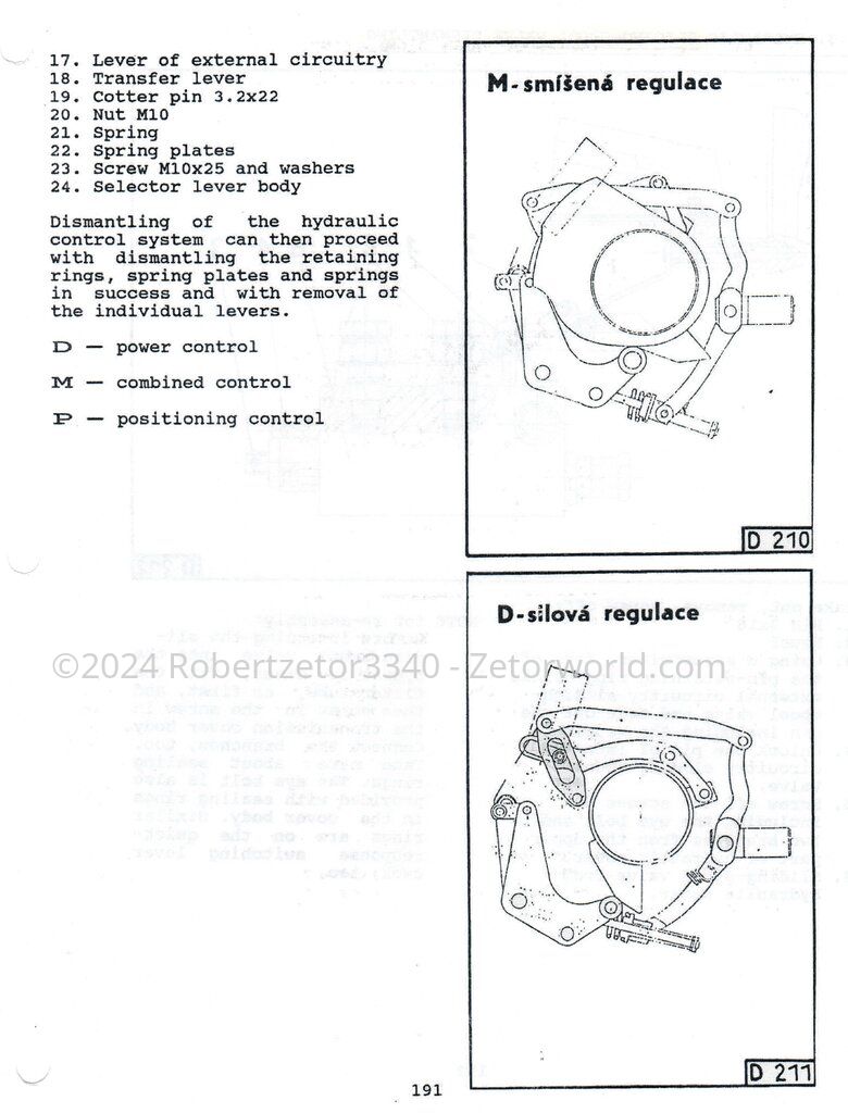

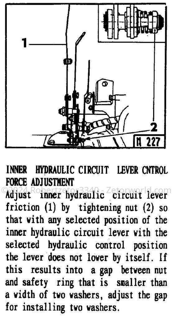

Anyways, Maybe this will be a little help :
