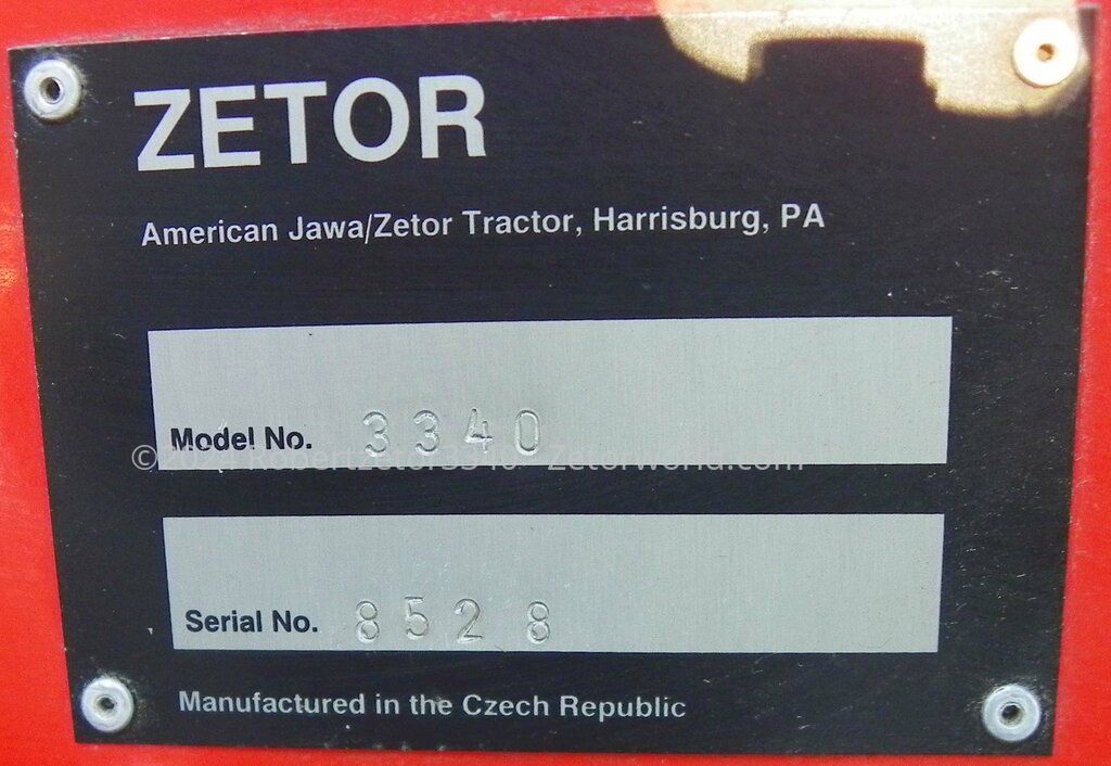

This is my Serial number, seems to be much shorter.
Up to Zetor 7340 the most one have shorter serial numbers. Its normal. :)
