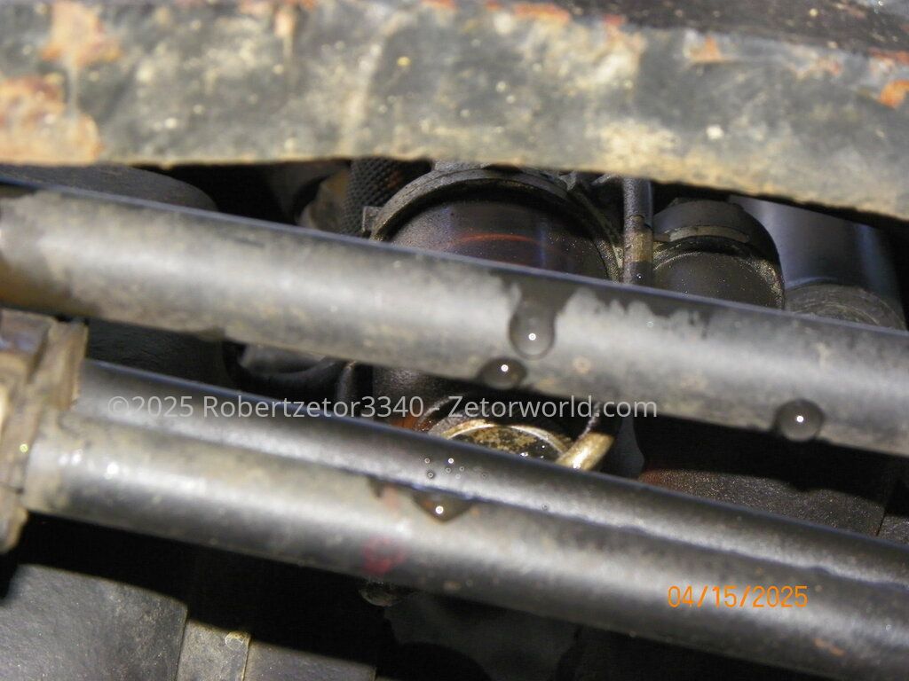

I have an intermittent fuel leak from the glass fuel bowl by the fuel injector.
It leaks after setting for a time and/or mostly when it is very cold out.
This leak has been fixing itself after the engine warms up.
Also because the loader frame and hydraulic lines are blocking access to it,
I am thinking I will need to drop the loader frame from the tractor to be able to get to it.
As you can see in the first picture, you can see it, but you can not get your hands in there even to touch it.

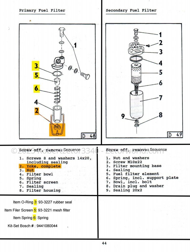

Part numbers:
  • 93-3221 mesh filtre ( 3,50 € with 19% German VAT at my shop), 93-3227 is the rubber seal for
    Its replaceable with the better one from Bosch (its bigger, withe plastic, finer and bigger mesh, 3,98 € with VAT at my shop)
    You have the to shorten the spring, but its easy to make.
    Or as a SET with Bosch number 9441080044
  • 93-3227 rubber seal ( 1,00 € with VAT at my shop) like to see at last picture...
No need to buy the glass or more and to import them, should have every Zetor dealer in the US market in mass.
And yes, its the same from Zetor 2011 to Zetor 7341 Turbo and UR2 also. ;)

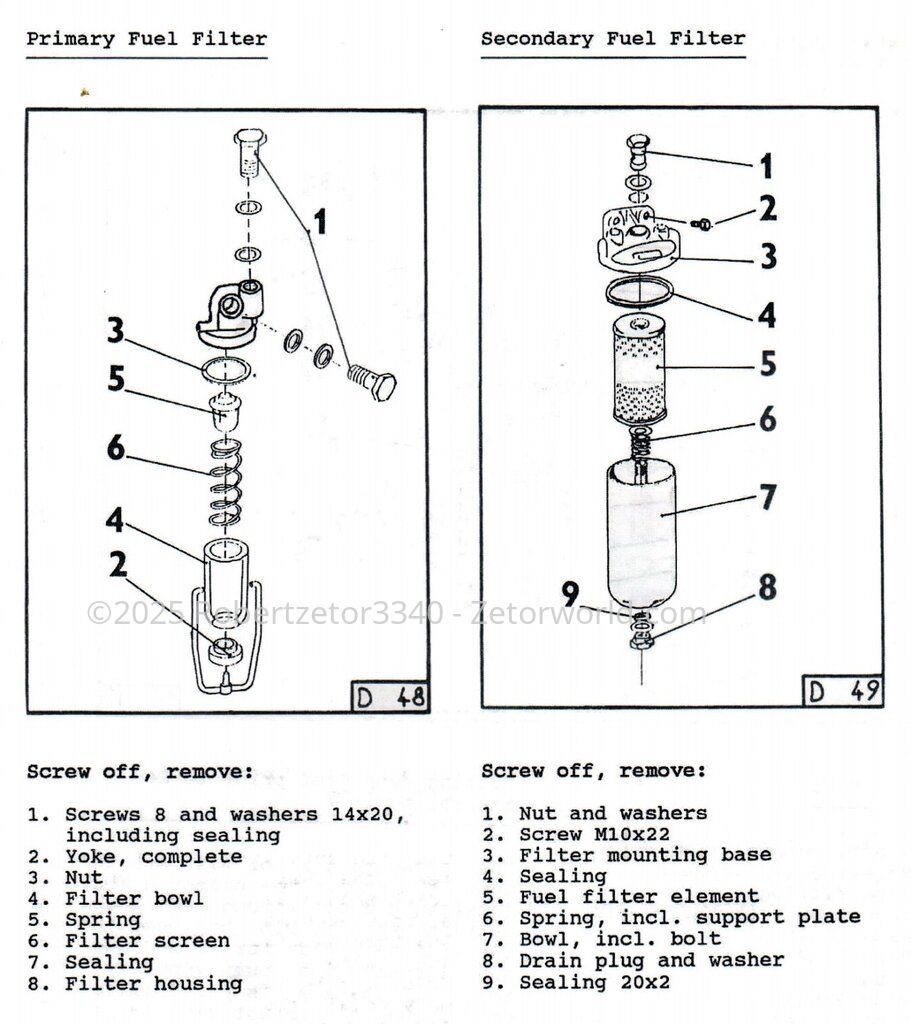

This diagram is from Zetor Service Manual page 44 of the Primary Fuel Filter figure D 48,
and at first I was misunderstanding that the numbered items in the figure D 48
to the list of numbered items below are not supposed to be a match to each other.
Anyways, the lower list of numbered items is a sequence process to unassembled the Primary Fuel Filter
and not to identify each Primary Fuel Filter part.
Seems to me this is not a normal way to design a service manual,
because it can cause misunderstandings, confusion and leaves out some proper part names for some items altogether.
