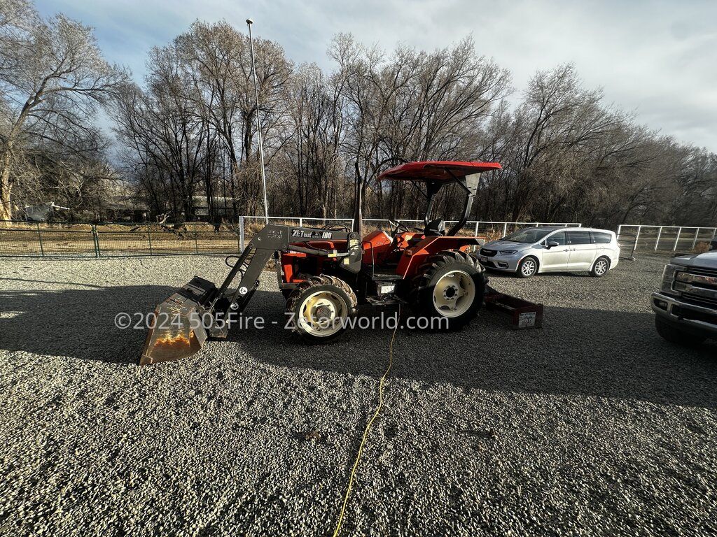

Hi this is my 3340 I just purchased. Currently chasing a not charging issue and I believe it needs fuel filters as it will run fine for a while then suddenly starting bogging and will die if I don’t feather the throttle. If I let it sit for awhile it will then run just fine. Is there a service manual available for this as I’m trying to figure out where all the filters are and how to change them and what fluids it uses.

Hello and welcome Chris! :)
Witch production year it is?
It sound so, I think you need a new filtre (I think its a single filtre, number 931260) and rubber seal (931262).
Manual is aviable from Zetor as a PDF for free.
Workshop books are also to find online at Ebay or tractor manual shops online.
Spare parts book in EN, DE, CZ, FR is also to find at Ebay or tractor manual shops online.
