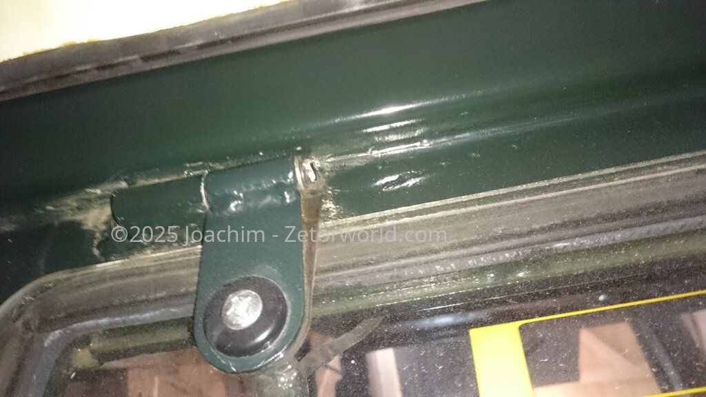

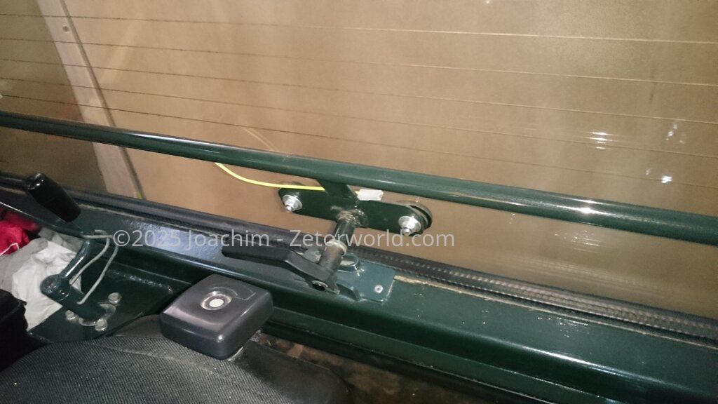

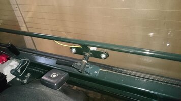

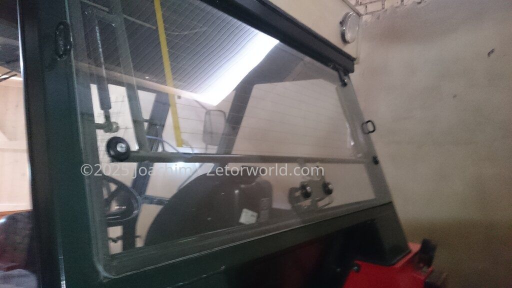

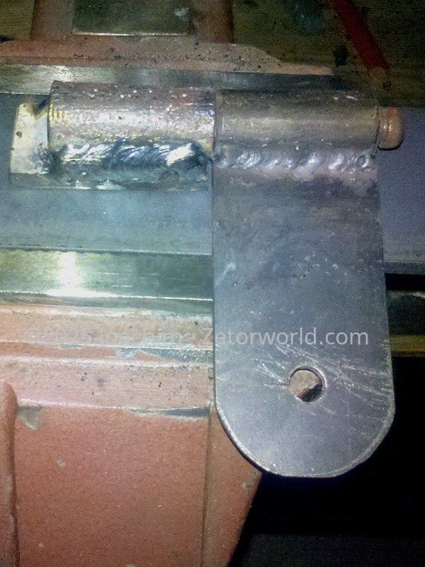

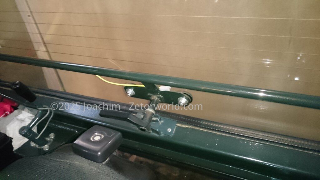

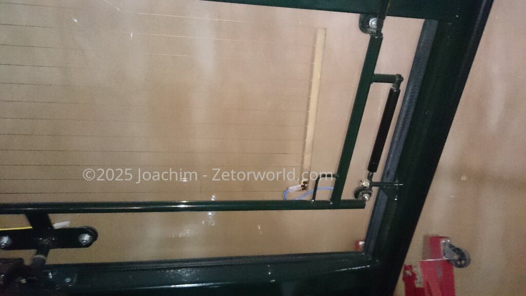

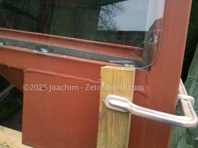

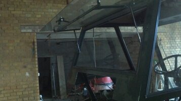

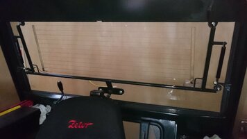

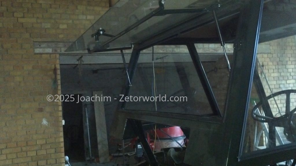

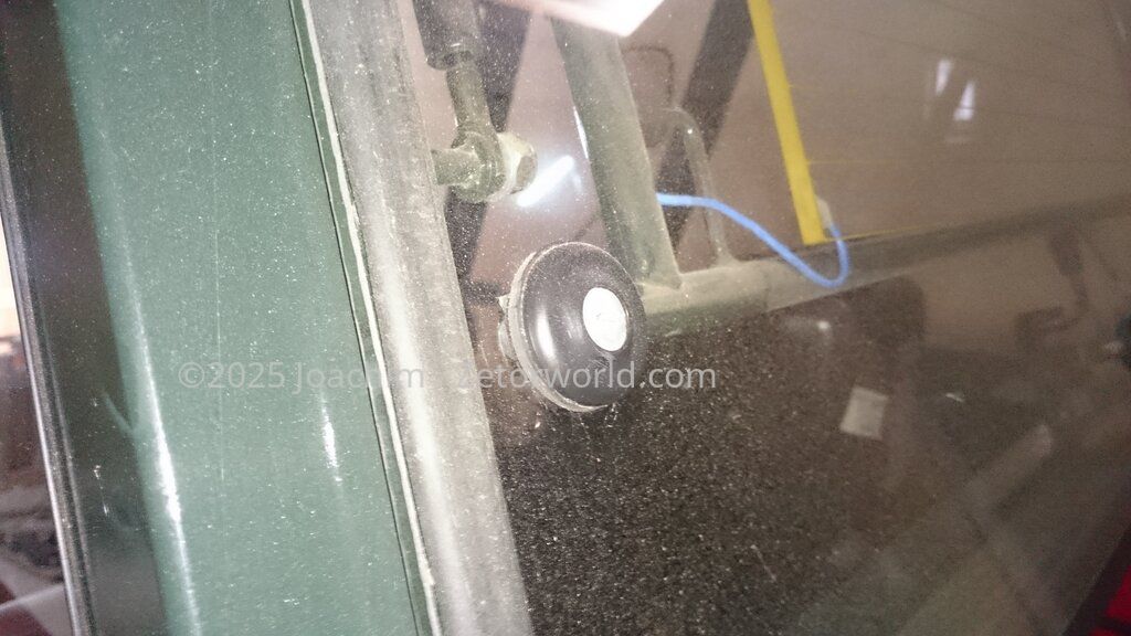

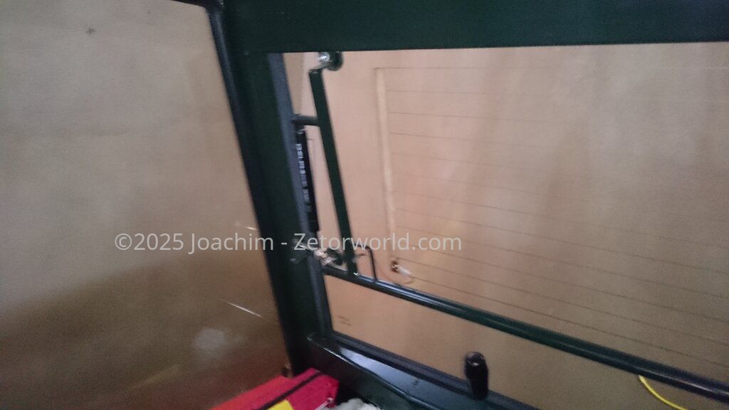

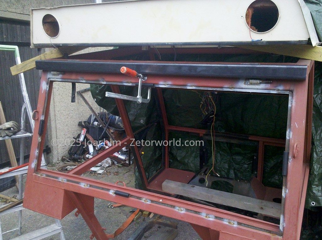

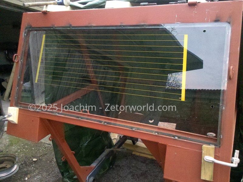

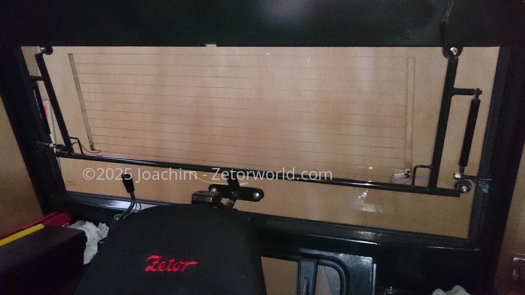

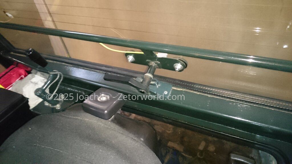

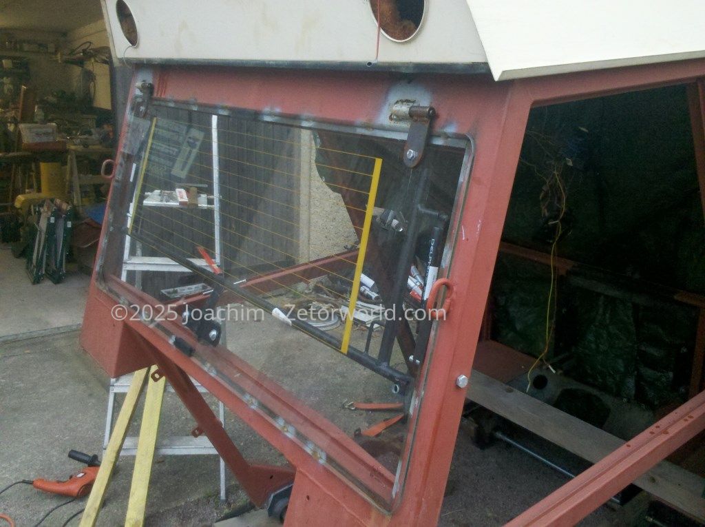

I had trouble getting all the rubber seals for this cab over 10 years ago. Because my rear window frame was also heavily rusted, I decided to convert the rear window to the Zetor 5211 version with the narrow Slovakian cab (metal roof).
Here's how I did it:

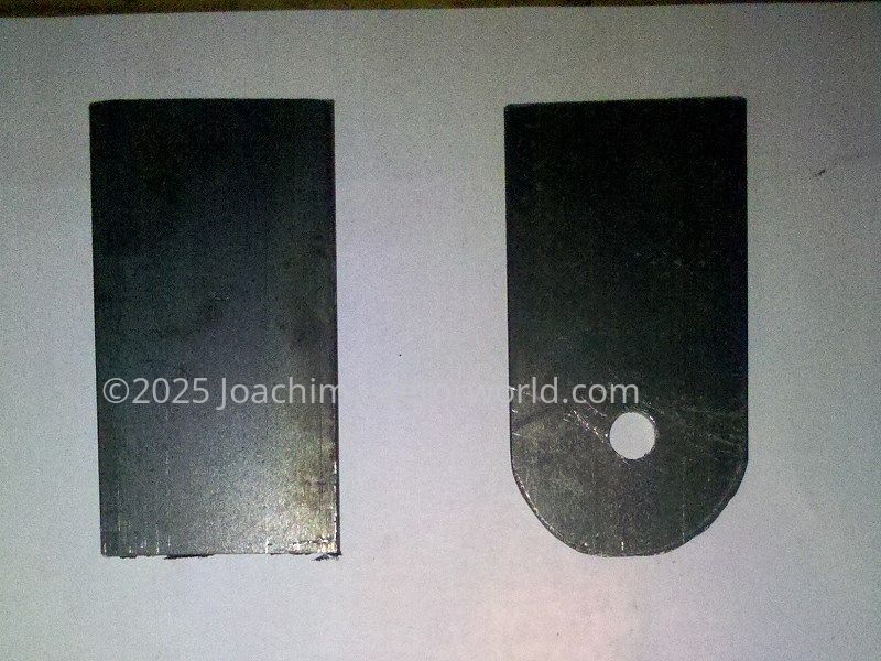

  • Welded four 10x2 sheet metal strips into the rear frame (spot welding)

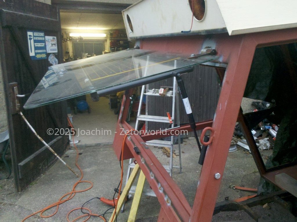

  • Welded two bolts on the left and right to hold the gas springs
  • Bought the rear window frame from the Zetor 5211 with the narrow cab
  • Bought a matching rear window
  • Re-welded the hinges
  • And because I still had a rear window handle from a CaseIH Maxxum, I also converted the stupid window lock from a plastic snap to a proper lock with 4 positions (closed, vent 1, vent 2, open).
In the end, it's much better than it was from the factory. ;)
Some pictures from:
Dachumbau_05.jpg DSC_3571.JPG DSC_3573.JPG DSC_3577.JPG DSC_3575.JPGDSC_3576.JPG DSC_3578.JPG DSC_3579.JPG DSC_3580.JPG DSC_3581.JPG Heckscheibe_5011_10.jpg Heckscheibe_5011_11.jpg Heckscheibe_5011_Gasdaempfer_02.jpg Heckscheibe_5011_Gasdaempfer_03.jpg Heckscheibe_5011_Scharnierbau_01.jpg Heckscheibe_5011_Scharnierbau_02.jpg Heckscheibe_Einbau_02.jpg
This means you can easily open the rear window with one hand, even while driving. It seals much better (no more water ingress), and thanks to the ventilation settings you'll never have fogged-up windows again.
... and yes, I mounted also the cab roof from a Zetor 5211 on my Zetor 5011 cab - because, its the better one. ;)
